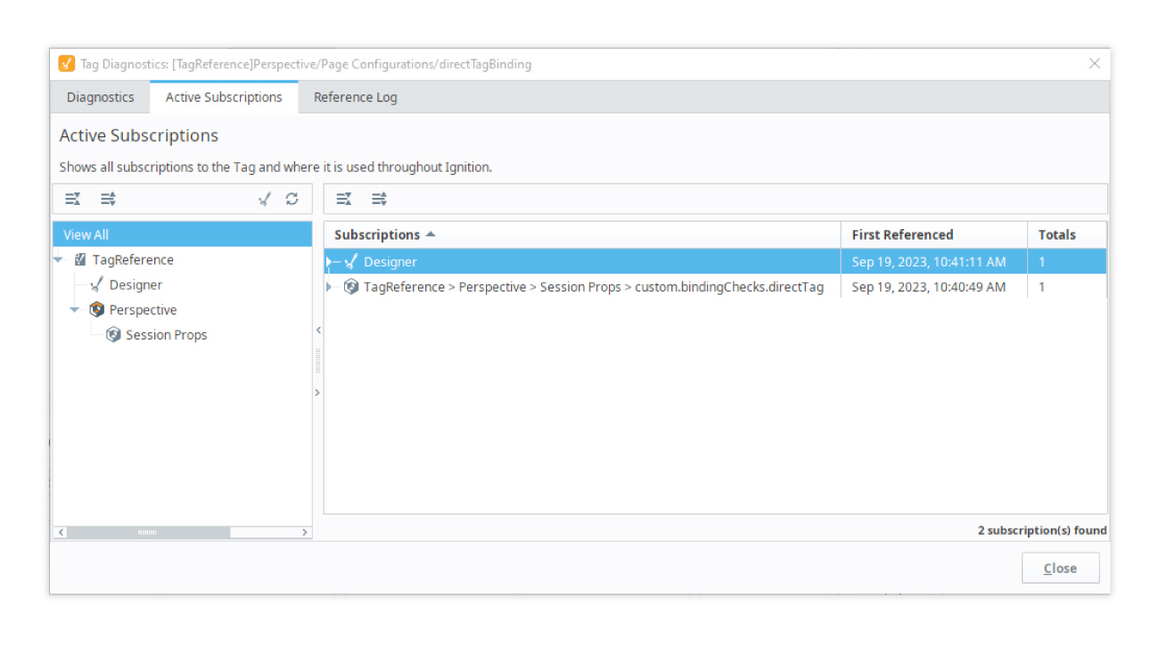

Tip 1: View Tag Utilization With Active Subscriptions
Thanks to the Tag Reference Tracker, you can use Active Subscriptions to quickly view where you’re using a tag. First, ensure that the Tag Reference Tracker is enabled in your gateway settings. Then, in the Ignition designer, just right-click on a tag, and select “View Tag Diagnostics.” From there, you can access Active Subscriptions. “It gives you the root container, any containers that are inside of that root container, and then all the way down to the property and what type of binding that is using that tag,” Tyson says.
