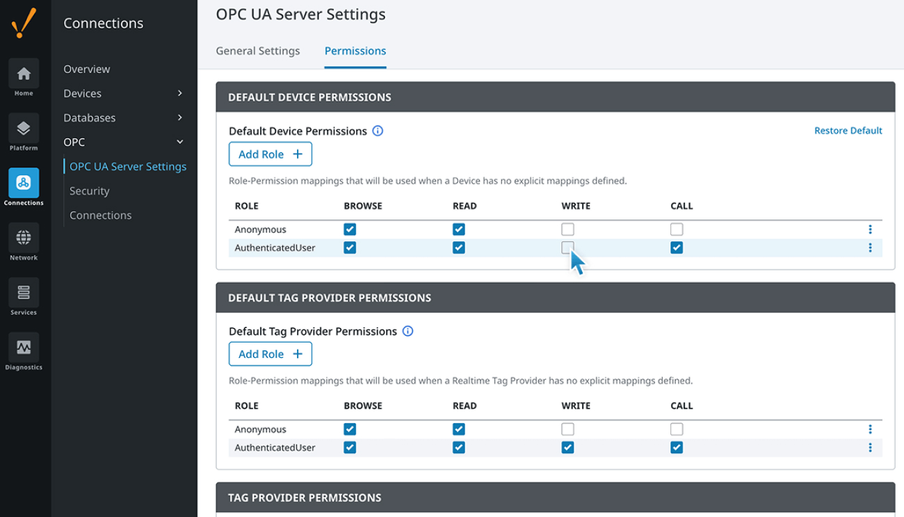

OPC UA Roles Tips
The new OPC UA Roles feature in 8.3 enables you to pick and choose which users have access to which tags. And with the latest OPC UA 1.05 specification, you can allow third-party access to specific devices, tag providers, or folders, and can control the read and write permissions granted with that access. Thanks to this new functionality, you can build Industry 4.0 systems that are more secure and connected than ever.
“Ignition’s famous OPC UA server got a major upgrade,” Dorsey says. “No longer are security controls only on the server itself. In 8.3, OPC UA tag permissions allow for granular access control to individual tags for individual users. This allows for more modern, industry-standard, hardened SCADA systems.”
Rosenkrans adds, “The latest implementation of Roles and Permissions in devices and exposed tags takes the Ignition OPC UA server to the next level by allowing for better control over access to data when clients are connected to it.”
The ability to create Industry 4.0 security roles is exceptionally useful for those wanting to bridge the OT/IT gap. As Goetz explains, “The OPC UA Roles feature transforms Ignition from a self-contained SCADA system into a secure, multi-tenant data broker for your entire enterprise. You can now confidently serve live OT data to any number of IT applications (like MES, ERP, or cloud analytics platforms). You have fine-grained, cryptographic control over exactly which application can see which specific data. This is a foundational piece for building a secure and scalable Industry 4.0 architecture, enabling true IT/OT convergence.”
