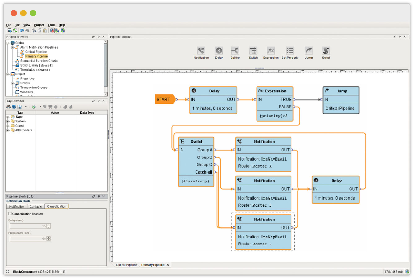

By using a simple drag-and-drop interface, you can build various types of alarm notification logic, including: delay, escalation, consolidation, and selection
Alarm Notification Pipelines
Configure alarm notifications to go to whoever you want, whenever you want, for whatever reason you want. Pipelines control what happens between when an alarm goes active and when it is sent out to personnel. Any alarm scenario is easy to set up with the module’s drag-and-drop interface which lets you build a variety of custom alarm notification pipelines, including: consolidation, delay, selection and escalation.
- Consolidation: Combine multiple alarms into a digested message.
- Delay: Hold off on sending notifications until they require attention.
- Selection: Distribute different alarms to different groups of contacts.
- Escalation: Send higher priority alarms to a different contact or group.
